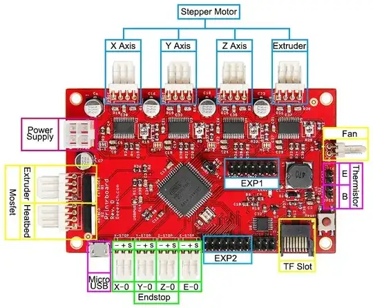

There is this google sheets file which provides some of the information.

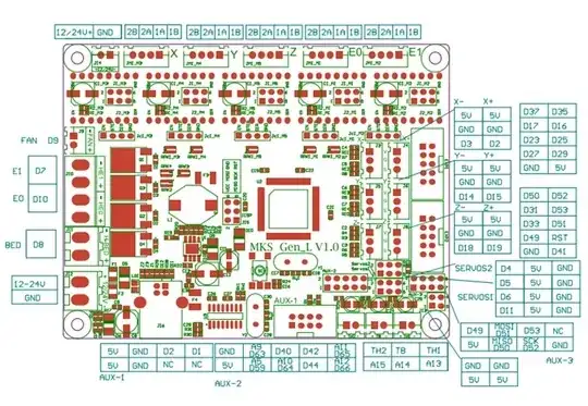

This image has the categories of each pin labeled. But I'm looking for where the pin numbers on the board correspond to the numbers in Marlin, similar to this image for the MKS Gen L:

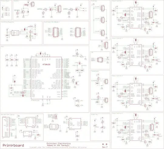

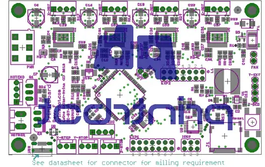

As FarO suggested, from github:Printrbot/printrboard/revF2 (via RepRapWiki - Printrboard - Revision History), the EagleCAD board layout and schematics are contained in the printrboard-revF2.zip:
  • Printrboard.sch
  • Printrboard.brd
This is the EagleCAD schematic:
Printrboard-revF2 schematic
Printrboard-revF2 board layout
Not quite the annotated diagram that you were after, unfortunately, but it might help.
