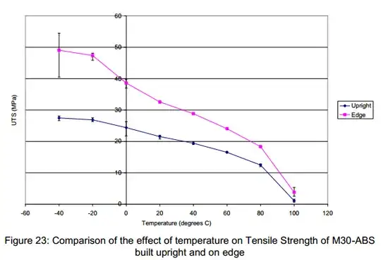

Even though some plastics may appear mechanically suitable at first sight, there are long-term issues with using thermoplastics for elevated temperature service. The material becomes weaker and less dimensionally stable under load as the temperature approaches the glass point of the polymer. For example, here is some Stratasys test data for ABS strength versus temperature:
Even if the plastic survives a few uses, it may creep and warp over time. And that might be fine, depending on your needs! People have printed working coffee cups out of ABS before. For some definition of "working" you can make print a working coffee mug. It's just not going to work at the level of longevity and reliability that people typically expect from hot beverage containers. (Imagine if the handle breaks and pours scalding liquid in your lap.) PLA in particular tends to give out abruptly due to its unusual ability to creep to ultimate failure with very low elongations.

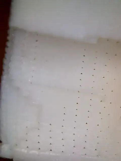

Then there is the question of whether ANY FDM printed part is ever safe for repeated food service use. One-time uses (such as throw-away cookie cutters) might be perfectly fine, but repeated use introduces additional problems because FDM parts are porous. They contain a microscopic void/grain structure that is perfect for trapping food debris and sheltering bacteria. Every FDM part is similar in that regard to an old, scratched, wooden cutting board. They are difficult to effectively sanitize. A high-temp dishwasher cycle will do the job, but that imposes significant thermal stress on thermoplastics.
Here's an example micrograph I took of voids in a printed part (strands all aligned the same way to highlight the shape):
These voids will also allow liquids to leak unless careful print settings are used. Over-extruding with multiple perimeters, or doing some kind of post-print sealing can make water-tight parts. It's not hard, just takes some experimenting.
