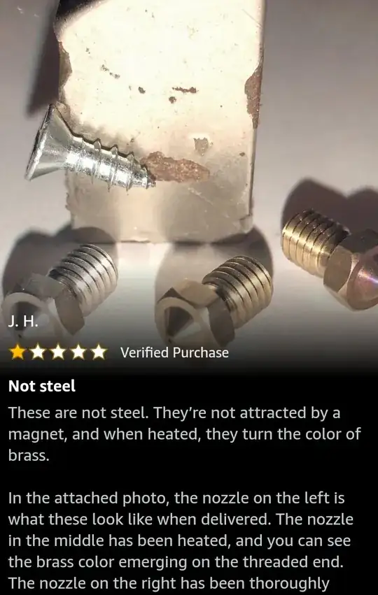

Normally stainless steel is magnetic. But whenever i order stainless steel nozzles from Amazon, they are not magnetic. This makes me think they could be brass coated in something like aluminum. However, there are many types of steel.
I've attached an image of someone who reviewed these nozzles. He says they are not stainless steel because they are not magnetic.
But whenever I order "stainless steel" nozzles, even from other sellers, they are not magnetic. i already returned one pack from another seller and just received a nonmagnetic one from a third seller.
So that's it? Amazon just sells junk now? Or is there a way I can easily tell whether these are something other than colored brass / good for abrasive or high temp printing. Here is the product that was reviewed: AUSTOR 13 Pieces Stainless Steel 3D Printer Nozzles 0.2 mm, 0.4 mm, 0.6 mm, 0.8 mm, 1.0 mm Extruder Nozzle Print Head for E3D Makerbot https://www.amazon.com/dp/B07CHZMGRH/ref=cm_sw_r_cp_apa_i_XtrNDbRMVH8SW

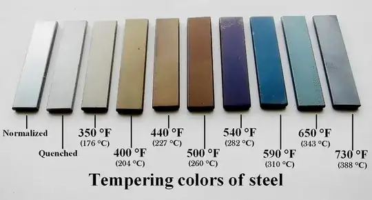

Tempering/Annealing behavior
The very fact that the nozzles do change color to a brassy color that is commonly called straw is proof that it is indeed steel: heating up a piece of steel does alter the steel and also alters the surface color in a process called tempering. The color is only the surface, and the mild straw color would become orange-brown, purple, pale blue teal and yellow if you were to heat it higher. Take a look at the tempering colors of steel here: Steel temper colors
In contrast, brass acts differently when heated and tempering is somewhat different. Subjecting the piece of brass to heat you will not temper but anneal it and you get colors differently. Instead of becoming straw before blue, Brass becomes dark, starting with its pale gold to go over a dark "antique" look to before going green, teal, purple-blue, red and then losing its color like this piece of a polished brass plate shows:

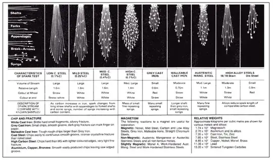

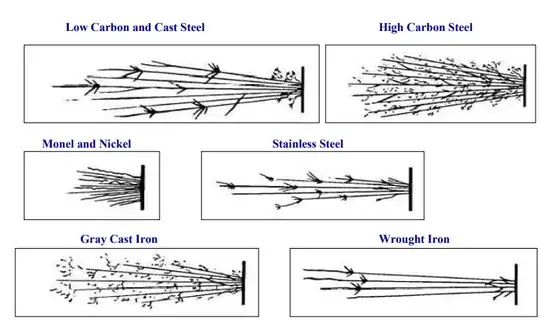

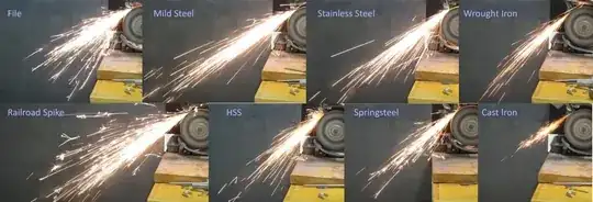

Sparktest
If you want to scrap one, get an angle grinder or another power tool to grind at the nozzle. Steel sparks red-orange to whitish and depend on the mix, Carbide sparks very short and orange. Stainless creates a HUGE shower of sparks, yellow-white and dense, no burstes and branching. Copper, aluminium and Brass do not spark. Titanium is very bright white. It can tell you what kind of steel you have: Stainless steel typically has medium-to-long, non- to low-branching, non- or low-exploding sparks.
Photos of a spark test a spark test pattern chart a different spark test pattern chart

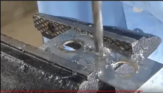

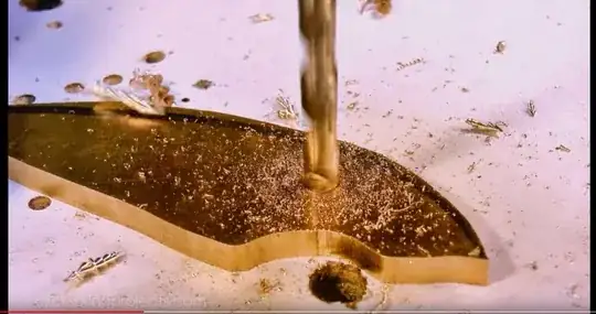

Drilltest
As we are at destroying a pair of nozzles, why not drill them? we should have done that before subjecting it to heat treating and grinding, but alas... Basically, we clamp the piece down and take an HSS drill to drill out the center.
Brass needs a different drill type but can be drilled and machined without coolant. Typical HSS drills from the home depot have a positive rake, brass wants a neutral or negative rake to drill or machine smoothly. If the piece grabs, creates short spials and dusty small flakes with an unmodified, new drill (or under positive rake machining), it drills like brass, as you see here from a Clickspring video on drilling brass:
HSS on Steel, ft. Clickspring
In contrast, stainless steel doesn't want to be machined without cooling at all and using high speed creates smoke quickly and nearly no chips at all. A moment later your tool starts to glow and gets a dull edge. If your drilling experiment turns a new drill blunt on high speeds or uncooled, you have stainless at your hands. To get chips, you need to work slow and have some sort of cooling. It is still a painfully slow process that needs a lot of pressure, but it gets larger, nesting chips like seen here from a Wayne Canning steel drilling tutorial:
Drilling HSS in Stainless Steel

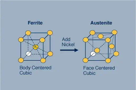

Stainless steel is created by adding elements (usually Chromium, but also Nickel) to steel. These added elements form an oxide layer with the outside air protecting the steel from corroding.
Whether stainless steel is magnetic or not depends on the added elements and the micro structure of the steel; some are and some aren't magnetic.
From physlink:
As for whether they (red. stainless steels) are magnetic, the answer is that it depends. There are several families of stainless steels with different physical properties. A basic stainless steel has a 'ferritic' structure and is magnetic. These are formed from the addition of chromium and can be hardened through the addition of carbon (making them 'martensitic') and are often used in cutlery. However, the most common stainless steels are 'austenitic' - these have a higher chromium content and nickel is also added. It is the nickel which modifies the physical structure of the steel and makes it non-magnetic.
So the answer is that you cannot determine by testing for magnetic properties if the nozzle is stainless steel or not. But if it is not magnetic, it can be stainless steel. Note that discoloration is possible, this is the oxide layer.

Note that the image you posted shows a Zinc plated steel screw, not a stainless steel screw.
