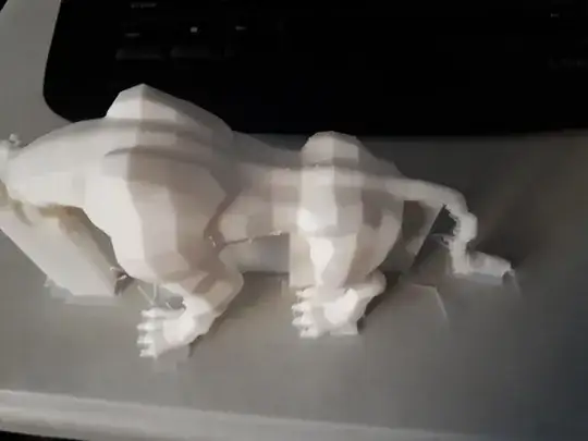

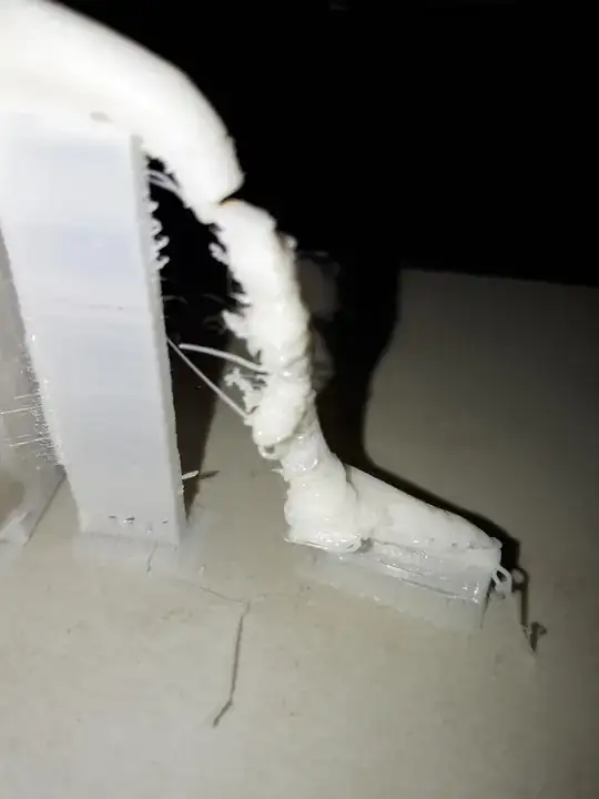

I'm using a Prusa Slicer with a FlyingBear Ghost 4 and got a wrong printing alignments on the Y axis only on a part of the printing object. What may cause this?
Here are the printed model pictures showing the problem:
Photo of 3D print
Close up of misalignment

This looks like your problems are lack of retraction and having the slicer's "overhangs" setting enabled.
Retraction is absolutely essential when your print has layers with multiple disconnected components, and even when it doesn't, it's usually important. Without retraction, material will continue to flow out of the nozzle after extrusion is supposed to have stopped, producing oozing/stringing and subsequent underextrustion (due to the material already having been lost elsewhere).
The "overhangs" setting is actively harmful unless your printer firmware has "linear advance" feature and you have calibrated it properly. Otherwise, when reaching part of the perimeter that's an overhang, the print head motion will slow down (I think PrusaSlicer does 10-20 mm/s for overhangs), but extrusion will continue at the full previous rate until pressure in the nozzle subsides. This is what's causing all the ugly sagging loops around the tail. Disable this misfeature so that print speed remains constant between overhang and non-overhang parts of the perimeters.
