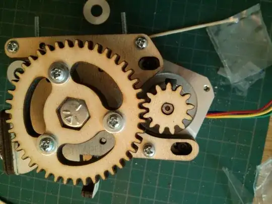

I have a Printrbot LC with the following extruder gears:
Stepper on the right, filament toothed gear inside, same size of the small stepper gear.
I don't have much more information besides the model of the motor (42BYGH4807), but the reduction ratio (NEMA stepper -> toothed gear on the filament) is about 2:1, the filament is pushed at half the circumference speed of the stepper motor gear (small on the photo).

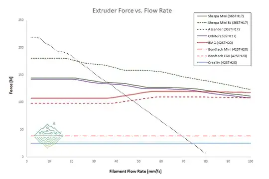

See also this graph from here which compares different extruders. You can see that between the Sherpa mini 8t and 10t (10 has a lower reduction ratio, so it needs to rotate slower for the same printing speed) the former has more torque. Since the maximum desired extrusion rate is still achievable, it made sense to increase the reduction ratio with a 8t motor.
