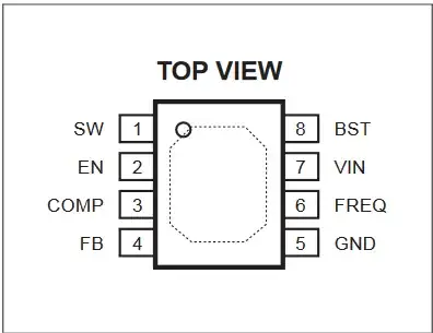

@Tom: There is a lot packed into your comment that required searching for info to even respond. The 5 V voltage regulator on my MKS Gen L v1.0 board looks to be an MP1584en chip. Seen in pic below from MP1584_r1.0.pdf:
MP1584en pin out
When I connect the board via USB and test the Vin pin, I see a steady ~4.2 V . When I remove USB and connect straight to the power supply I see a unsteady Vin between 6-7 V .
So I would like to trace from this MP1584EN back to my 12 V power source on the board. However, after searching it appears that the schematics for the MKS Gen L v1.0 are not available openly. Unless there is an avenue to find the schematic which I have overlooked. Anyone that can link me to them would be much appreciated.
Here is the schematic.
Anyway, the problem is the MP1584 regular is toast. There is no reverse biased protection diode going from output to input (arrow pointing towards input) in the schematic.
Most buck or linear voltage regulators aren't meant to be operated with Vout being higher than Vin, even briefly. There are internal parasitic diode structures inside that will get turned on by voltage in the wrong direction (higher Vout than Vin). Once turned on, the output capacitor happily dumps its charge through these diode structures and out to Vin.
This kills the regulator.
What results is typically an internal short of some sort in the chip.
So when you shorted Vm, that was also shorting the input to the 5V regulator and the input capacitor there, so suddenly there was 0V at Vin and ~5V at Vout. Poor chip never stood a chance.
This is not your fault, this is poor design (or a reckless cost saving decision), as accidentally shorting Vm is very easy to do on accident. A suitable diode would have cost ~1.3¢, not even two whole pennies and would have made accidental shorting of Vm be harmless. There is no valid reason not to include such a protection diode on the board.
Regardless, your only options are to either desolder the MP1584 and solder a new one onto the board, or, since you can talk to the board via USB (which provides its own 5V power to the board), desolder the MSP1584 (since it is shorting the input power to some degree) and simply keeping a USB charger of some sort plugged into the USB port (I wouldn't leave it connected to your computer since it doesn't have any USB isolation) to provide the 5V power rail instead.
The main problem is that bad chip. You gotta get it off the board before anything will be able to work unfortunately. Desoldering is relatively easy, especially if you don't care about the chip you're removing. Just be sure there are no shorts between the pads after you're done.
