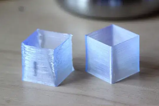

I've been trying a lot of different things to combat corners curling upward in the first few tens of layers after the bottom skin. To be clear, I'm not talking about corners of the first layer printed on the bed, but rather the points of the outline in layers above the base where direction of print motion changes discontinuously (discrete corner) or abruptly (turn with very tight curvature). Here's an image I found (not mine) that demonstrates:
print with curled corners next to one without

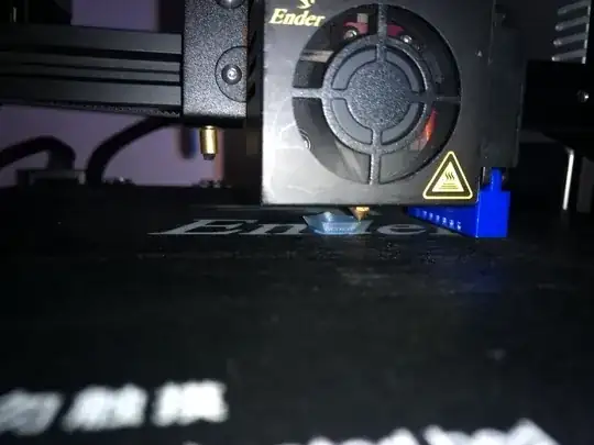

And a pic during print of the type of curling I'm talking about:
curling corners during printing

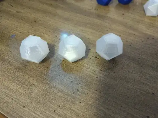

And some previous worse prints:
2 dodecahedra with very warped edges, one with minor distortion to one edge, shown bottom-up
My go-to worst test case for this now is a 20mm tall hollow dodecahedron with 0.8mm shell (hollow geometry, not just empty infill; 0% infill on a non-hollow model does even worse, shown above). For everything else I've tried, I've mostly been able to sovle the problem with combinations of
