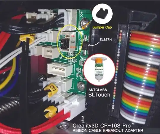

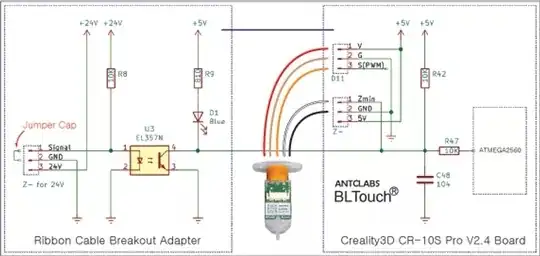

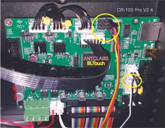

I found this and remember doing something similar on my TAZ 5 when I installed a proximity sensor on it. See BLTouch V3 on the Creality3D CR-10S Pro:
Creativity recommends connecting white and black lines to Z+ and downloading the Creativity firmware.
The BLTouch V3.x is enough just to install the jumper cap on the CR-10S Pro and it works well in Default(OD) and 5V Logic Mode. (including Smart V3.0 produced by April 4th, 2019)
This solution is complete and safe. You do not need to remove the capacity or add a pull-up resistor for the BLTouch installation in the CR-10S Pro.
Cause of problem: When the inductive proximity sensor is removed from the Ribbon cable breakout adapter, 24V is kept at EL357N pin1
(Anode) through R8, so EL357N pin 4(Collector) is fixed LOW.
Solution: Install the Jumper cap between the Z-connector signal and GND pin on the Ribbon cable breakout adapter.. It prevent the
EL357N pin4(Collector) to fix LOW.
How to install the jumper cap: Remove the inductive proximity sensor from the Ribbon cable breakout adapter for CR-10S PRO and
install the jumper cap as like the picture. This operation requires caution.
Board
※ Never install the Jumper cap between the Z-connector 24V pin and the GND pin on the Ribbon cable breakout adapter.
CR-10S Pro Wiring:
Schematic
See Schematic. Using the 5V Logic Mode without the jumper cap installation may break BLTouch or EL357N.
Wiring
