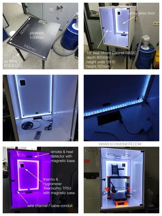

If you want to have an enclosure without actually building one, you can try a server cabinet. Just take out the server racks and use it as an enclosure. And, as there are many server cabinets available, you could probably find one that suits your needs. Currently, I have my FlyingBear P902 3d printer enclosed in a server cabinet. And, although the doors and removable sides might have air gaps, you can always just tape that off (or use an insulation strip). Hope this works.
You could also look at this website: Perfect 3D printer enclosure for Prusa i3 MK3
