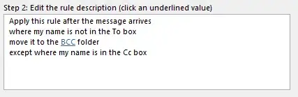

You can create a rule based on BCC you receive, but it's not immediately obvious as you have to resort to the message headers. The steps are:
X-MS-Exchange-Organization-Recipient-P2-Type: BccThis rule should help:
Apply this rule after the message arrives
where my name in not in the To Box
move it to [folderOfYourChoice] folder
except where my name is in the Cc box
The problem with this rule is that some email senders use X-MS-Exchange-Organization-Recipient-P2-Type: Bcc and some (GMail in this example) use X-MS-Exchange-Organization-AuthAs: Anonymous.
I created this rule:
my name NOT in the to line
This catches CC and BCC but that is OK for my purposes.
I did this in Outlook 2011 by setting up a rule that sends everything to my bcc folder unless I am addressee or cc'd. That seems to work.
