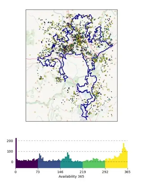

... finally, here's how I would plot it using EOmaps :-)
from eomaps import Maps
import geopandas as gpd
import pandas as pd
# read the data (no need to manually specify crs if .prj and .shx files are available!)
gdf = gpd.read_file(r"Asheville_City_Limits\Asheville_City_Limits.shp")
data = pd.read_csv(r"Asheville_listings.csv")
m = Maps(crs=Maps.CRS.GOOGLE_MERCATOR, figsize=(6, 8))
m.add_gdf(gdf, fc="none", ec="darkblue", lw=2)
# plot the data
m.set_data(data, "longitude", "latitude", crs=4326, parameter="availability_365")
m.set_shape.scatter_points(size=5)
m.set_classify.EqualInterval(k=5)
m.plot_map(ec="k", lw=0.25)
m.add_colorbar(hist_bins=100, label="Availability 365")
# add a background map
m.add_wms.OpenStreetMap.add_layer.default(alpha=0.5)
