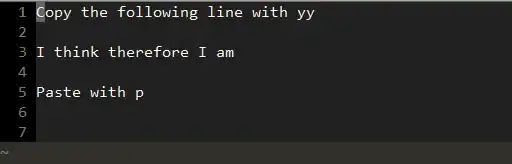

yy or Y to copy the line (mnemonic: yank)
or
dd to delete the line (Vim copies what you deleted into a clipboard-like "register", like a cut operation)
then
p to paste the copied or deleted text after the current line
or
Shift + P to paste the copied or deleted text before the current line
