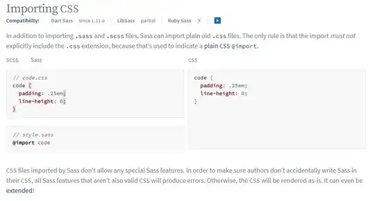

1As of 2018, using [SASS `@import`](https://sass-lang.com/documentation/file.SASS_REFERENCE.html#import) in a regular CSS file should just generate a regular [CSS @import](https://developer.mozilla.org/en-US/docs/Web/CSS/@import). That means one more HTTP request and no combining or compressing. If some implementations behave differently then I'd say it's a non-standard feature that diverges from the language spec. – Álvaro González Nov 09 '18 at 13:47

I just want to point out that as December 2014, this issue has been resolved. It is now possible to import css files directly into your sass file. The following PR in github solves the issue.
The syntax is the same as now - @import "your/path/to/the/file", without an extension after the file name. This will import your file directly. If you append *.css at the end, it will translate into the css rule @import url(...).

This was implemented and merged starting from version 3.2 (pull #754 merged on 2 Jan 2015 for libsass, issues originaly were defined here: sass#193 #556, libsass#318).
To cut the long story short, the syntax in next:
to import (include) the raw CSS-file
the syntax is **without `.css`** extension at the end (results in actual read of partial `s[ac]ss|css` and include of it inline to SCSS/SASS):@import "path/to/file";to import the CSS-file in a traditional way
syntax goes in traditional way, **with `.css` extension** at the end (results to `@import url("path/to/file.css");` in your compiled CSS):@import "path/to/file.css";
And it is damn good: this syntax is elegant and laconic, plus backward compatible! It works excellently with libsass and node-sass.
__
To avoid further speculations in comments, writing this explicitly: Ruby based Sass still has this feature unimplemented after 7 years of discussions. By the time of writing this answer, it's promised that in 4.0 there will be a simple way to accomplish this, probably with the help of @use. It seems there will be an implementation very soon, the new "planned" "Proposal Accepted" tag was assigned for the issue #556 and the new @use feature.
UPD: on 26 October 2020 lib-sass was deprecated, therefore issue #556 was immediately closed.
__
answer might be updated, as soon as something changes.

Simple.
- 318
- 2
- 7
8I've tried this, but it wont pull the contents of the file into that one when compressing it, it will just keep the @import line. – GSto Aug 19 '11 at 15:01
1Lowest scored answer, but ironically, this seems to be the right way, now. Including the suffix is the right thing to do. – Wyck Nov 23 '18 at 03:25
