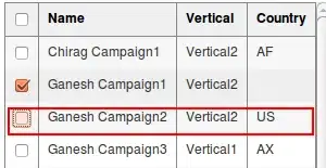

I have been trying to create a customized toggle button in native android, But I'm not able to achieve it. Here is the Image which I want to look like :
can someone help me on this?
