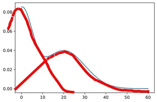

It is not entirely clear what you are trying to accomplish. You are fitting a GaussianMixture model to the concatenation of the sum of the values of pdfs of two gaussians sampled on a uniform grid, and the unifrom grid itself. This is not how a Gaussian Mixture model is meant to be fitted. Typically one fits a model to random observations drawn from some distribution (typically unknown but could be a simulated one).
Let me assume that you want to fit the GaussianMixture model to a sample drawn from a Gaussian Mixture distribution. Presumably to test how well the fit works given you know what the expected outcome is. Here is the code for doing this, both to simulate the right distribution and to fit the model. It prints the parameters that the fit recovered from the sample -- we observe that they are indeed close to the ones we used to simulate the sample. Plot of the density of the GaussianMixture distribution that fits to the data is generated at the end

The results are
fitted means: 22.358448018824642 0.8607494960575028
fitted stdevs: 8.770962351118127 5.58538485134623
fitted weights: [0.42517515 0.57482485]
as we see they are close (up to their ordering, which of course the model cannot recover but it is irrelevant anyway) to what went into the simulation:
mean1, std1, w1 = 0,5,0.5
mean2, std2, w2 = 20,10,1-w1
And the plot of the density and its parts. Recall that the pdf of the GaussianMixture is not the sum of the pdfs but a weighted average with weights w1, 1-w1:
