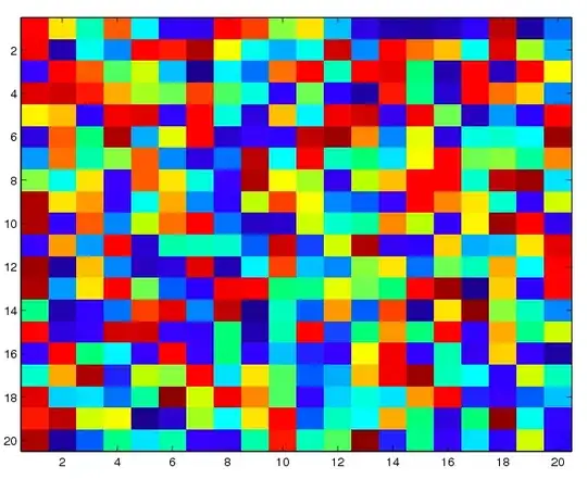

The problem is reproducible on a Mac, and the issue is with the eps renderer rather than MATLAB. For e.g., saving imagesc(rand(20)) and viewing with Preview and GSview results in the following:
Preview screenshot
GSview screenshot
Clearly, the information is not lost. It is just not interpreted/read correctly by some EPS viewers. The solution is simple: use GSview to view your eps images. You can download it from here
On Macs especially, if your end application is latex/pdflatex, you will have to explicitly set it to use GS/GSview, because otherwise, it will default to the Quartz engine, which is baked into the OS.
