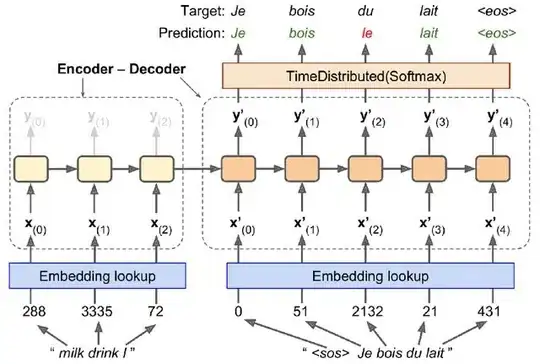

I am reading "Hands-On Machine Learning with Scikit-Learn and TensorFlow" by Aurelion Geron. I am currently reading the Encoder-Decoder section of the book and I stumbled upon some code that I don't fully understand, and I find the explanations from the book to be unsatisfactory (at least for someone like me, a beginner). The following picture presents the model we are trying to implement (or to be more precise, we will implement a model that is similar to the following picture, not exactly this model):
(picture from Hands-On Machine Learning with Scikit-Learn, Keras, and TensorFlow, chapter 16, page 543, figure 16-3)
This is the code that was used (again, the above model is not the exact thing we are going to code. The author explicitly said that the model we will build is just similar to the above picture):
