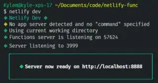

Run
You should be able to run normally via netlify dev
Which will expose the function at the following address:
http://localhost:8888/.netlify/functions/hello?name=Kyle
