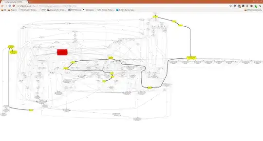

In this screenshot the image is selected, you can see the handles around it.
