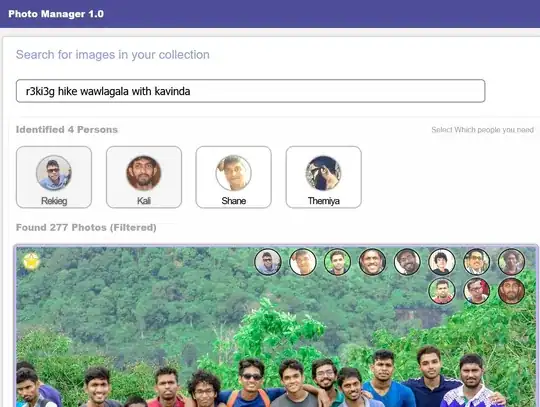

Also, if nested interactive content is invalid, how are we supposed to have something like this:
A card which is clickable as a whole, and also has a clickable secondary CTA inside it. I know a workaround would be to have a primary and secondary CTA inside the card, but shouldn't the above be allowed as well?

In the above example, I am achieving this by using a clickable div inside the button, but that is not semantic (?) and also functionality wise, it is an interactive element inside another one. I am trying to understand that even if I use this workaround, is it fundamentally wrong to have nested interactive elements? is it a bad design/usability practice?
