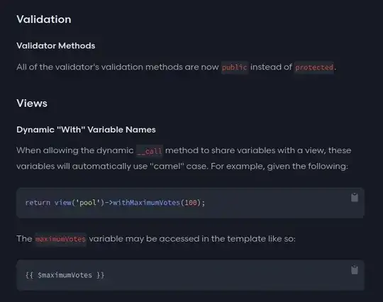

After figured out that, I went back to the docs and didn't find anything related to that.
Anyway, it seems that after 5.5 if you want to send the errors and the inputs to the view, instead of only do return back();, you will need to use something like return back()->withInput()->withErrors($exception->validator ?? '');.
