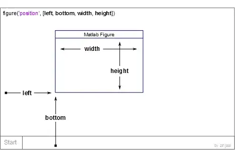

66
Write it as a one-liner:
figure('position', [0, 0, 200, 500]) % create new figure with specified size
