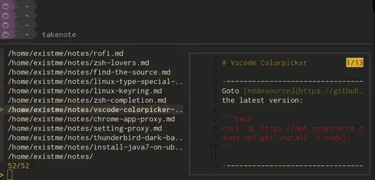

local file=$( find -L "$HOME/notes/" -print 2> /dev/null | fzf-tmux +m )
zle reset-prompt
compadd $file
return 1
Unfortunately, the above code doesn't work because of zle reset-prompt, if I remove it then the result would be like this:
And after selecting the file it would turn into:
Which as you see will corrupt the prompt and the command itself.
