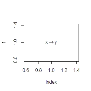

When I create a plot in the RStudio viewer pane with plotly, I am left with a large white margin around the plot. This is normally fine, but not when using a non-standard color scheme. Moreover, this white margin seems to also exist when the image is exported, or generated in RMarkdown etc.
Does anyone know of a way to remove this?
Here is some example code to demonstrate:
