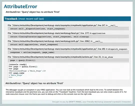

Here is a thread, How-to-debug-in-django-the-good-way should be applicable to App Engine.
I like:
- Werkzeug Debugger provides in webpage interactive console debugging.
- Tipfy ships with Werkzeug.
Werkzeug Debugger in action:
You simply click on a line in the stacktrace and it gives you a console then and there!!
