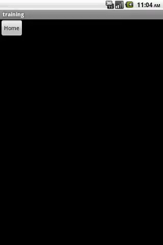

I presume this will be a bit of a noob question so please bear with me but i am wondering how the values Shown In Blue are generated for the different source files within R.Java file as shown? Thanks!

@Sush Oh fair thanks man , Guess this leads to my next question.... so if you look at the attached picture you will see that there is a source called "do_junk_clean" which is used as this ` android:layout_above="@id/do_junk_clean">` I was wondering how do i make a different id that says "@id/do_Process_kill" – Thomas Mortell Jul 07 '17 at 19:01
1Make/assign an androidWidget in your xml file with `android:id="@+id/do_Process_kill"` – Firoz Memon Jul 07 '17 at 19:06
