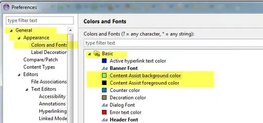

I know you're trying to change the highlight color, but if the problem is contrast you can change the content assist background color, and get this kind of contrast
The setting is General->Appearance->Color Basic->Content Assist Background
Then it's just a matter of finding colors that please you.

That changes the colour for the un-selected items in the list. The question is how to change the colour of the currently selected item in the list. – dan carter Jul 10 '14 at 01:35
Did I not make that obvious with my opening statement? And the body of the question made it seem likely that the OP really wanted better visibility of the selected item. – Tod Jul 10 '14 at 21:08
