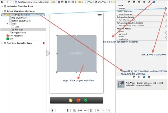

Follow the screen shot below
after connecting inYourViewController.h
@interface inYourViewController : UIViewController<UIWebViewDelegate>
now you are ready to implement the delegate methods in inYourViewController.m file.
or
you can do the same thing from code.
After connecting the webView with view controller via IBOutlet,In inYourViewController.m file's viewDidLoad Method write
self.yourWebView.delegate=self
In inYourViewController.h
Now you are ready to implement the delegate method of webView.Thanks
