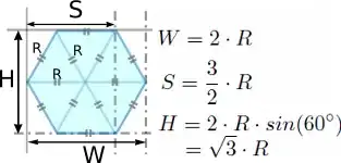

Looking at the other answers I see that they have all a little over complicated the problem. The following is an order of magnitude quicker than the accepted answer and does not require any complicated data structures, iterators, or generate dead memory and unneeded GC hits. It returns the hex cell row and column for any related set of R, H, S or W. The example uses R = 50.
Part of the problem is finding which side of a rectangle a point is if the rectangle is split diagonally. This is a very simple calculation and is done by normalising the position of the point to test.

The rest of the problem is just a matter of splitting the grid into (R / 2) by (H / 2) cells width each hex covering 4 columns and 2 rows. Every 1st column out of 3 will have diagonals. with every second of these column having the diagonal flipped. For every 4th, 5th, and 6th column out of 6 have the row shifted down one cell. By using % you can very quickly determine which hex cell you are on. Using the diagonal split method above make the math easy and quick.

// the values as set out in the question image
var r = 50;
var w = r * 2;
var h = Math.sqrt(3) * r;
