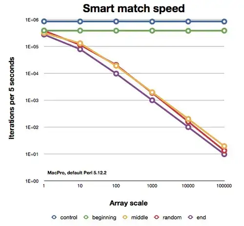

Now, before I start this benchmark, I expect that if the smart match can short circuit (and it can; its documented in perlsyn), that the best case times will stay the same despite the array size, while the other ones get increasingly worse. If it can't short circuit and has to scan the entire array every time, there should be no difference in the times because every case involves the same amount of work.
Here's a benchmark:

Here's how the various parts did. Note that this is a logarithmic plot on both axes, so the slopes of the plunging lines aren't as close as they look:
So, it looks like the smart match operator is a bit smart, but that doesn't really help you because you still might have to scan the entire array. You probably don't know ahead of time where you'll find your elements. I expect a hash will perform the same as the best case smart match, even if you have to give up some memory for it.

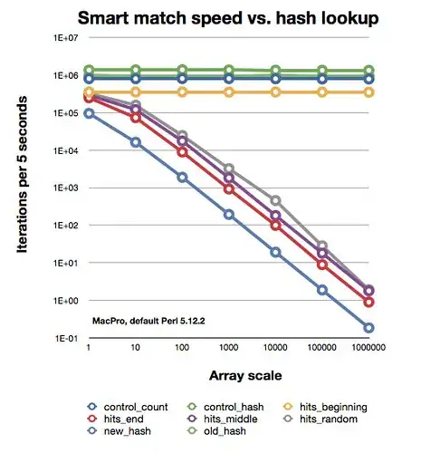

Okay, so the smart match being smart times two is great, but the real question is "Should I use it?". The alternative is a hash lookup, and it's been bugging me that I haven't considered that case.
As with any benchmark, I start off thinking about what the results might be before I actually test them. I expect that if I already have the hash, looking up a value is going to be lightning fast. That case isn't a problem. I'm more interested in the case where I don't have the hash yet. How quickly can I make the hash and lookup a key? I expect that to perform not so well, but is it still better than the worst case smart match?

Here's the plot. The colors are a bit difficult to distinguish. The lowest line there is the case where you have to create the hash any time you want to search it. That's pretty poor. The highest two (green) lines are the control for the hash (no hash actually there) and the existing hash lookup. This is a log/log plot; those two cases are faster than even the smart match control (which just calls a subroutine).
There are a few other things to note. The lines for the "random" case are a bit different. That's understandable because each benchmark (so, once per array scale run) randomly places the hit elements in the candidate array. Some runs put them a bit earlier and some a bit later, but since I only make the @random array once per run of the entire program, they move around a bit. That means that the bumps in the line aren't significant. If I tried all positions and averaged, I expect that "random" line to be the same as the "middle" line.
Now, looking at these results, I'd say that a smart-match is much faster in its worst case than the hash lookup is in its worst case. That makes sense. To create a hash, I have to visit every element of the array and also make the hash, which is a lot of copying. There's no copying with the smart match.
