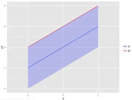

Lastly, we add the second geom_smooth layer.
plot_obj +
geom_smooth(aes(y = y1, ymin = y1_lwr, ymax = y1_upr), stat="identity", fill="blue", alpha=0.2) +
geom_smooth(aes(y = y2, ymin = y2_lwr, ymax = y2_upr), stat="identity", fill="red", alpha=0.2)
Notice that the top line is no longer red in the last chart. Why is this happening and how can it be fixed? Thank you!
