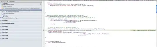

Here are some problems I'm running into:
The program is only reading moneyInput in the first line, instead of reading both moneyInput and currency. Secondly, for each input, the user must press [return] twice (note each of the empty lines in between each input).
The program also terminates inconsistently. In the image example above, after it finally accepts a valid moneyInput and currency and converts the value, the program does not terminate. It terminates prematurely if the moneyInput is entered first, followed by an invalid currency on a second line, like so:
But here, it terminates properly after a successful run (although this still isn't exactly right because it only is "successful" if moneyInput and currency are input on separate lines; ideally, the user should be able to enter both on the same line and the program prints the appropriate conversion):
However, one thing the program does do well is responding repeatedly to invalid (specifically, blank inputs):
And actually, in the case above, aside from the fact that [return] had to be entered twice when prompting for moneyInput and that it didn't terminate after a successful run, everything is working exactly as desired:
the user gets to try repeatedly until a valid input, and in the case where
moneyInputis valid butcurrencyis not, the user only has to enter a valid input forcurrency(i.e. they don't have to re-entermoneyInputwhen only thecurrencywas invalid).
