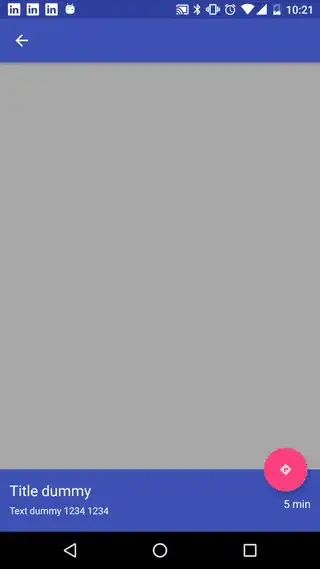

I'm assigned to make a UI that behaves similarly to how Google Maps shows a bottom-sheet for a found result.
It has three different phases:
- Bottom content. The upper area is still touchable and won't scroll anything at the bottom
- Full-screen content, while the upper area has a large header.
- Full-screen content, while the upper area has just the toolbar.
Here's what I'm talking about on Google Maps:
