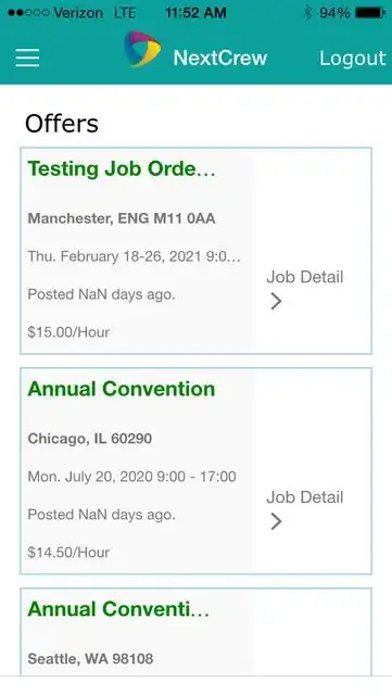

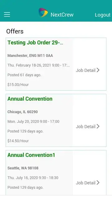

very strange issue I am seeing. I have attached 2 screenshots, one of which is on Android the other is on iOS. When I test my app on emulator, I get the correct number. When I test on Android, I get the correct number. But when it's on iOS, for some reason my Math.Ceil (in javascript) returns a NaN number on iOS. Here's my function currently:

Attached Images (sorry the size is so big):
- Android
- iOS
