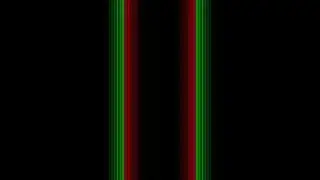

Which produces a rectangle that looks like:
The lines show distance from the rectangle. It works fine but ONLY for distances OUTSIDE the rectangle. Inside the rectangle the distance is a static 0..
How do I also get accurate distances inside the rectangle using a unified formula?
