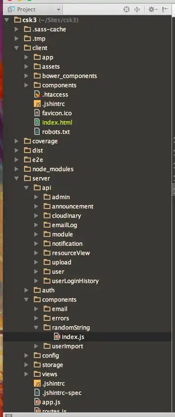

server/api/upload/index.js
'use strict';
var express = require('express');
var controller = require('./upload.controller');
var router = express.Router();
//router.get('/', controller.index);
//router.get('/:id', controller.show);
router.post('/', controller.create);
//router.put('/:id', controller.update);
//router.patch('/:id', controller.update);
//router.delete('/:id', controller.destroy);
module.exports = router;
server/api/upload/upload.controller.js
'use strict';
var _ = require('lodash');
//var Upload = require('./upload.model');
var aws = require('aws-sdk');
var config = require('../../config/environment');
var randomString = require('../../components/randomString');
// Creates a new upload in the DB.
exports.create = function(req, res) {
var s3 = new aws.S3();
var folder = randomString.generate(20); // I guess I do this because when the user downloads the file it will have the original file name.
var matches = req.body.upload.match(/data:([A-Za-z-+\/].+);base64,(.+)/);
