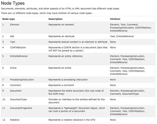

Want to check the type of Hello Stackoverflow? Simpy check the td's content's nodeType
//Gave your td an id of 'td'
alert($('#td').contents().get(0).nodeType);
This will return 3. A nodeType of 3 means it is a text.
Here is an image of each nodeType:
