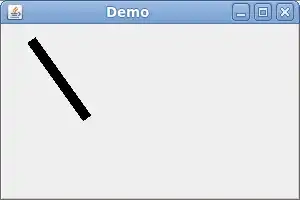

The following code produces the image below:

(Note that the setStroke method is not available in the Graphics object. You have to cast it to a Graphics2D object.)
