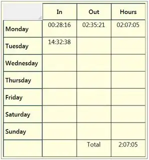

So looks like there is not any default support for changing the alignments here. Normally the <ContentPresenter> should have code like this:
<ContentPresenter SnapsToDevicePixels="{TemplateBinding SnapsToDevicePixels}"
VerticalAlignment="{TemplateBinding VerticalContentAlignment}"
HorizontalAlignment="{TemplateBinding HorizontalContentAlignment}"/>
Then we can change the VerticalContentAlignment and HorizontalContentAlignment in the style of the DataGridCell to change the alignments.
That means if using XAML code, your solution can be solved by just appending the above code. But if you want to use code behind, it's of course much longer and more complicated.

You can see that both solutions are fairly long but they are actually what you should do using code behind. That means we should always use XAML code as much as possible. Many features in WPF are designed mainly for XAML code, so using code behind is of course not straightforward and usually verbose.

However I've just tested it, looks like the default style is always applied to the DataGridCell, it's just overridden by the Setter you added (which set the same properties). Here is the testing code, the Trigger still works:
//change the highlight selected brush to Red (default by blue).
yourDataGrid.Resources.Add(SystemColors.HighlightBrushKey, Brushes.Red);
