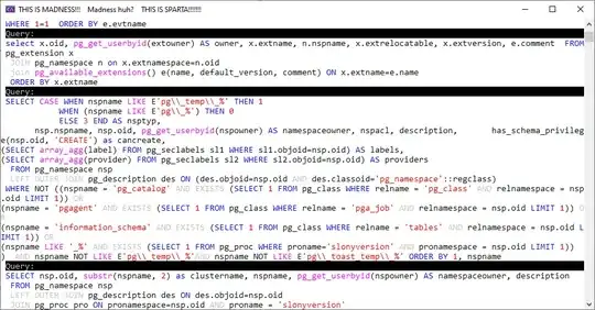

Instead of running any such crap, you can add a TCP-proxy in between your application and PostgreSQL-server.
Then your TCP-proxy reads all the sql-query-statements from what goes over the wire from your application to the server, and outputs it to console (or wherever). Also it forwards everything to PostgreSQL and returns the answer(s) to your application.
This way, you don't need to stop/start/restart your db-server, you don't need admin/root rights !ON THE DB-SERVER! to change the config file, and you don't need any access to the db-server. All you need to do is change the db connection string in your application (e.g. in your dev-environment) to point to the proxy server instead of the sql-server (the proxy-server then needs to point to the sql-server). Then you can see (in chronological order) what your <insert_profanity_here> application does on the database - and also, other people's queries don't show up (which makes it even better than sql-server-profiler). [Of course, you can also see what other people do if you put it on the db server on the old db port, and assing the db a new port. ]
I have implemented this with pg_proxy_net
(runs on Windows, Linux and Mac and doesn't require OS-dependencies, as it is .NET-Core-self-contained-deployment).
That way, you get appx. "the same" as you get with sql-server profiler.
Wait, if you aren't disturbed by other people's queries, what you get with pg_proxy_net is actually better than what you get with sql-server profiler.
Also, on github, I have a command-line MS-SQL-Server profiler that works on Linux/Mac.
And an GUI MS-SQL-Express-Profiler for Windows.
The funny thing is, once you have written one such tool, writing some more is just a piece of cake and done in under a day.
