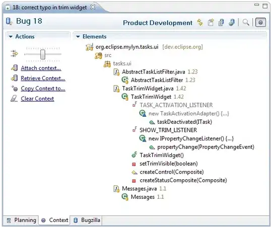

The other alternative is to use an IDE which support task-based context filtering.
For instance Eclipse Mylyn, that I mention in "Eclipse - easy access to frequently used folders?".
Mylyn is a task-focused interface using context:
That might not be part of your stack, but it illustrates how that issue of getting "only few files related to the change I'm doing in my working folder" can be addressed.
