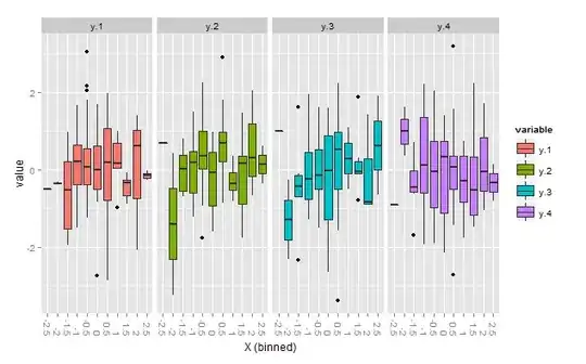

The facet_wrap as shown in this solution ( Multiple plots by factor in ggplot (facets)) gives me out each variable in an individual plot, but I would like to have the boxplots of each variable next to each other for each bin of x in one diagram.
ggplot(dfmelt, aes(value, x, group = round_any(x, 0.5), fill=variable))+
geom_boxplot() +
geom_jitter() +
facet_wrap(~variable)
This shows the y-variables next to each other but does not bin x.
ggplot(dfmelt) +
geom_boxplot(aes(x=x,y=value,fill=variable))+
facet_grid(~variable)
Now I would like to produce such a plot for each bin of x.
