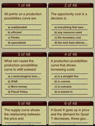

A screenshot of what it looks like is the following:
Notice that there are only 2 items in the tableView now. But there is actually another item (the first one) that's above these two. However, that one is automatically scrolled up when the view shows up, and if I try to scroll it down, the first item is indeed visible, but the tableView automatically bounces back when I release the scrolling gesture.
