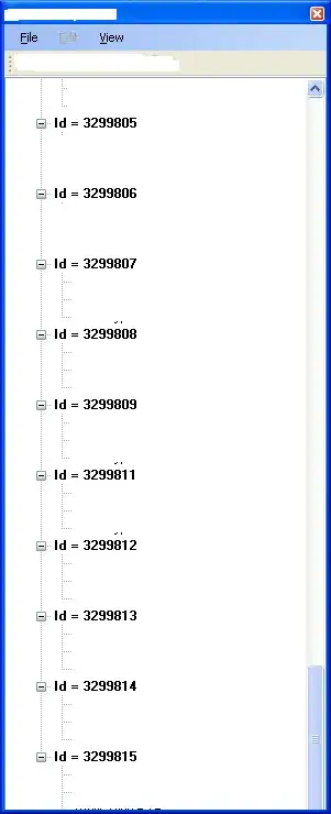

Here is what I put in my Car().Owner(), consider Container should be Car (this is an other project with the same problem)
I hover my mouse over newValue.
