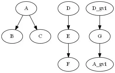

... running gvpack -u 1.dot 2.dot 3.dot | dot -Tjpg -ogvp1.jpg gives the following graph gvp1.jpg:

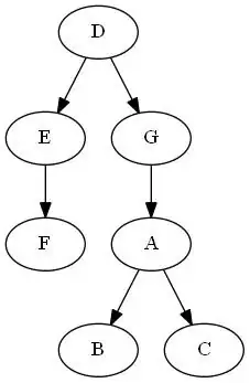

As you can see, gvpack has relabelled the duplicate node names. However, we can easily reverse the re-labelling using gvpack -u 1.dot 2.dot 3.dot | sed 's/_gv[0-9]\+//g' | dot -Tjpg -ogvsub.jpg, which produces the following graph gvsub.jpg:
This approach relies on the subgraphs having node names in common, so it might be necessary to insert additional nodes in the sub-graph .dot files to achieve this.
