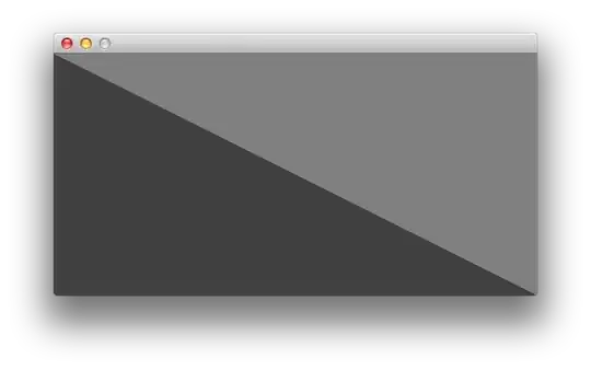

I'm converting some code from OpenGL 1.3 to OpenGL ES 1.1. It's a 2D game, so it mostly comes down to rendering textures onto quads. There is no immediate mode in OpenGL ES, so I had to use vertex buffer objects instead.
But it seems like only one of the two triangles making up each quad handles transparency. Here's a screenshot:
Here's how I render textured quads right now, which causes that:
