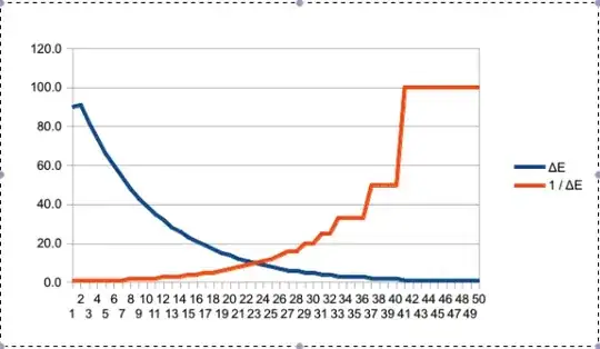

Update
My answer does not indicate that this is best solution. It's just my current solution that I thought I would share.
