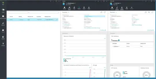

Another variation on new Azure portal (bypassing the database), #1 go to SQL servers directly; #2 click on the DB Server you want to update the password for, #3 click the pencil, #4 update the password, confirm and save.
- 3,163
- 23
- 19
2@Sam If I click `Resource groups >>> database resource >>> Icon for SQL Server, not database` I see the pencil next to "Reset password" at the top, where Richard has it pictured. hth. – ruffin Mar 22 '18 at 23:15
