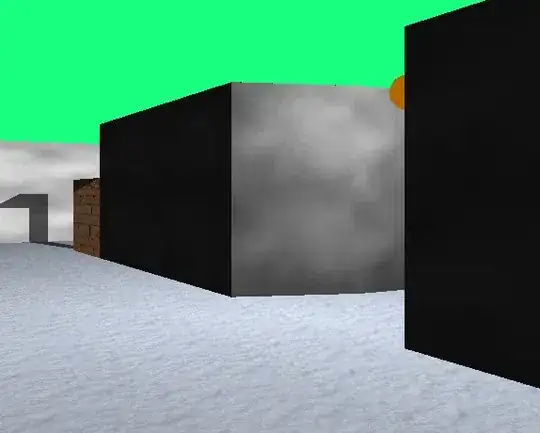

thx Najzero for giving me 5 reputation,now i can capture the screen to show the effect.I will append a detail description follow.
the z-pass algorithm effect:
when i'm not in the effect,it's ok!(the orange pot represent the light)
but when i'm in the wall_shadow,it's not ok!the wall_shadow is gone,although the brick_shadow is still there.
so I need z-fail algorithm to solve this problem.but the last effect my code realized is like this:
the tick represent the shadow effect is right,the cross represent the shadow shouldn't appear on the object.
another screenshot,
