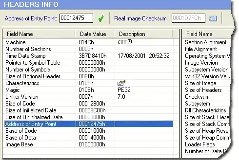

There are a few more differences regarding the structure you could mention.
- Both DLL and EXE share the same file structure - Portable Executable, or PE. To differentiate between the two, one can look in the
Characteristicsmember ofIMAGE_FILE_HEADERinsideIMAGE_NT_HEADERS. For a DLL, it has theIMAGE_FILE_DLL(0x2000) flag turned on. For a EXE it's theIMAGE_FILE_EXECUTABLE_IMAGE(0x2) flag. - PE files consist of some headers and a number of sections. There's usually a section for code, a section for data, a section listing imported functions and a section for resources. Some sections may contain more than one thing. The header also describes a list of data directories that are located in the sections. Those data directories are what enables Windows to find what it needs in the PE. But one type of data directory that an EXE will never have (unless you're building a frankenstein EXE) is the export directory. This is where DLL files have a list of functions they export and can be used by other EXE or DLL files. On the other side, each DLL and EXE has an import directory where it lists the functions and DLL files it requires to run.
- Also in the PE headers (
IMAGE_OPTIONAL_HEADER) is theImageBasemember. It specifies the virtual address at which the PE assumes it will be loaded. If it is loaded at another address, some pointers could point to the wrong memory. As EXE files are amongst the first to be loaded into their new address space, the Windows loader can assure a constant load address and that's usually 0x00400000. That luxury doesn't exist for a DLL. Two DLL files loaded into the same process can request the same address. This is why a DLL has another data directory called Base Relocation Directory that usually resides in its own section -.reloc. This directory contains a list of places in the DLL that need to be rebased/patched so they'll point to the right memory. Most EXE files don't have this directory, but some old compilers do generate them.
You can read more on this topic @ MSDN.

Both DLL and EXE are Portable Executable(PE) Formats
A Dynamic-link library (DLL) is a library and therefore can not be executed directly. If you try to run it you will get an error about a missing entry point. It needs an entry point (main function) to get executed, that entry point can be any application or exe. DLL binding occurs at run-time. That is why its called "Dynamic Link" library.
An Executable (EXE) is a program that can be executed. It has its own entry point. A flag inside the PE header indicates which type of file it is (irrelevant of file extension). The PE header has a field where the entry point for the program resides. In DLLs it isn't used (or at least not as an entry point).
There are many software available to check header information. The only difference causing both to work differently is the bit in header as shown in below diagram.

Two things: the extension and the header flag stored in the file.
Both files are PE files. Both contain the exact same layout. A DLL is a library and therefore can not be executed. If you try to run it you'll get an error about a missing entry point. An EXE is a program that can be executed. It has an entry point. A flag inside the PE header indicates which file type it is (irrelevant of file extension). The PE header has a field where the entry point for the program resides. In DLLs it isn't used (or at least not as an entry point).
One minor difference is that in most cases DLLs have an export section where symbols are exported. EXEs should never have an export section since they aren't libraries but nothing prevents that from happening. The Win32 loader doesn't care either way.
Other than that they are identical. So, in summary, EXEs are executable programs while DLLs are libraries loaded into a process and contain some sort of useful functionality like security, database access or something.
